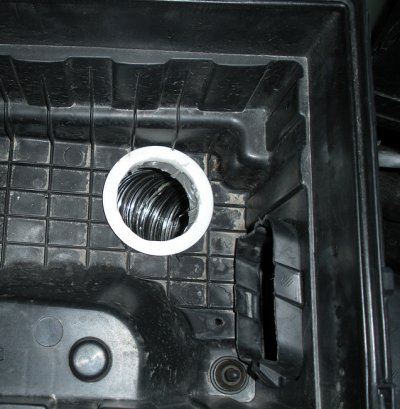

If mostly looking for the forced RAM Air Intake benefits, just do the DIY Intake mod.
Go buy this, for $20.
3623-plus-2018-jpg.504755
Place a scoop, on the left side of the radiator on the radiator support.
If wanting it look PURTY, buy this for $37
3620-jpg.504754
Or, just buy this for $15 and paint it black
Go buy this 3 inch floor drain collar. $4 or so.
use a dremmel tool to remove all the inside lattices.
Place the collar in a 3 inch hole you drill in the bottom of the cold air intake.
End up looking like this
cai04-jpg-jpg.504819
Couple of hose clamps and now you got true forced ram air intake for under $50.
It would be interesting to see if this mod even raises the pressure under the filter in the airbox. One would need a fairly sensitive manometer to measure pressure change in the sub in/wc range (0.001 in/wc).
Nothing is done to prevent any pressure from the "ram air mod" from going out the stock opening in the airbox.

Are there any documented performance gains for ram air on a RAM? I looked into it long ago for another application and unless you were getting into above-legal speeds there was no measurable increase.
Do not think it is the pressure that is the greatest benefit and doubt if pressure raises it much, if at all.
My own thinking is an increase in air flow volume, under tachometer red line conditions, when engine is grasping for all the air it can get.
Then, while pressure might remain relatively the same, the flow should be greatly increaed.
Akin to having a bigger straw in your cup.
I did the Mod on my 2014, took a a nap.
Wife woke me up with, You know that Thingy you did to your truck? It really made a difference.
I just blew up the interstate on ramp and passed people with no problems. You truck really takes off, now.
She is a Sunday School teaching Grandma, who is used to her twin turbo charged, Explorer ST, rate of acceleration.
Normally drives like a old Lady until she wants to merge or pas, then it Mario Andretti Time.

My snorkel doesn’t even make any noticeable differences. I haven’t used any air measurement devices besides just reading the engine computer. It’s a “forced air intake” but unless I’m going over 100 mph there is very minutely any positive pressure going to the air filter. If you removed the stock air elbow and did the forced air directly into there it would be more efficient than drilling a hole into the bottom because you would be making positive air pressure to the filter. The stock elbow is not such a large restriction but making positive pressure to the air box would actually help by reducing how much the engine has to work to pull air through the filter. That would increase the efficiency of the engines intake stroke and if you’re lucky would help get more air density into the cylinder. Like I said though you would need to be around 100 mph and up to actually have enough airflow to create enough positive pressure to make a difference.
It's probably on equivalent of changing the airbox lower over to one from an EcoDiesel as per this mod:
To be fair, it's not really a matter of an increase in pressure (which implies a positive number, i.e. forced induction), rather a reduction in vacuum.
A reduction in vacuum is analogous to a reduction in restriction, hence potentially higher airflow.
The question is whether or how much difference that makes. I say no discernible difference on a street driven vehicle unless maybe if you go to extremes, such as putting a 3" high by air-dam-width scoop on and plumb it with a streamlined course to the airbox.

The stock set-up does have more internal vaccumn then i thought it would have. I have a 3" duct from the lower valence plumbed into the side of my airbox,and one time for $h!t's and giggles on the dyno,i decided to put a balled up rag up against the added opening,and as soon as the truck went WOT on the dyno,it sucked the rag right into the airbox easily.By no stretch will it add a positive pressure into the airbox even at a 100mph,but it does reduce the internal vacumn in the box. The Hellcat Challengersl use a headlight duct that feeds air from the inner headlight into their airbox,it's a pretty common mod on the naturally aspirated 5.7 and 6.4 Challengers to add the lower Hellcat airbox and the headlight duct,whether it adds anything for power who knows,but it's also not gonna reduce power either
