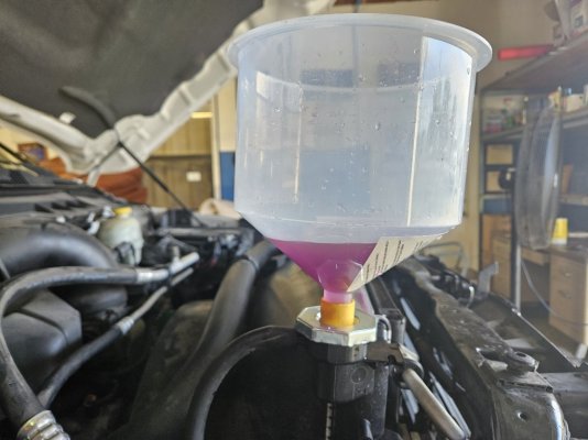

IMO use the OEM purple 10 year coolant. It seems to be good stuff but it doesn't like to be mixed with other random types of coolant.
68163848AB is the part # for the OAT concentrate. It's about $22/gallon on Amazon. Buy 2 gallons and 2 gallons of distilled water at your local grocery store, and you'll have 4 gallons of 50/50 once you mix it.
If you only drain the radiator, you'll get less than two gallons of old coolant out. Removing the block drains will get most of the coolant out. Pull the grille to remove and empty the reservoir (I found what I believe to be casting sand in mine).
You can run some extra distilled water through the heater core and rad to get leftover coolant out.
When I did my cam/lifter job, I pulled my radiator, block drains, reservoir, and heater hoses. It took almost 4 gallons of 50/50 mix to refill it.
Theres a bleeder screw on the water pump as well. I used a coolant funnel that attaches to the radiator to refill it while the system was burping.
After filling, it might take a few heat cycles and adding small amounts of coolant each time to get the last bit of air out (unless you have one of those fancy vacuum-fill devices, which I do not). Nose-up on an incline helps, too.
Good luck.
