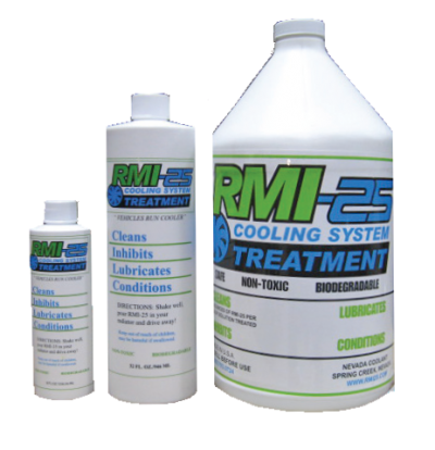

rmi-25 will take any gunk in cooling system and deposit in overflow where it gets stuck, then you have to wet vacuum it out. It straight up works. If you can drive 500 miles your cooling system will not have blockage if it is from traditional dex blockage or coolant slime. Stuff is harmless, I would get the medium size and drop in the entire bottle... dont mess with those block bolts, yours sounds just like mine, simply wont come off. if we keep trying, we will break it, then be real sorry.
