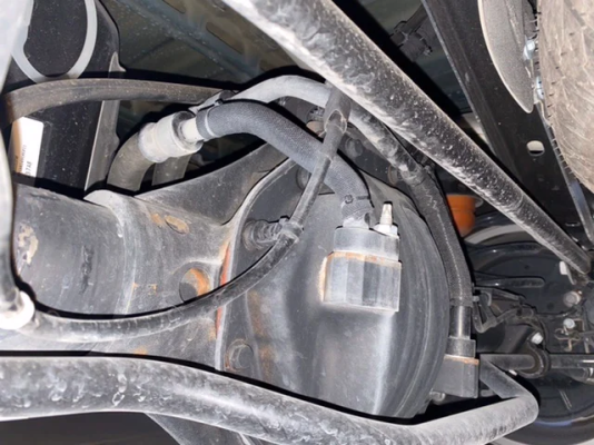

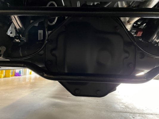

I have a 21 ecodiesel limited. It has coolant in rear differential supposedly for fuel economy. Mine has a leak and there are 2 seals that cost $3 each list price that are unavailable no ETA or anything. Part number 68373120AA. I’m located in north central Wisconsin. I like this vehicle a lot no other issues and great fuel economy but I’ve been down 4 weeks today. If anyone knows where 2 of these are I’d be very grateful.
I cannot tell if it’s the cover leaking or the fitting, best guess is rusted cover by welds. Dealer has been quite helpful so far.
Also what is best way to connect with live person at Ram couldn’t care less (Ram Care)?
Thanks in advance!

Rear ends operated for well over a 100 years with out coolant heating them,why don't you dump the coolant lines feeding it,and either Tee the coolant lines together,or get rid of them completely.
Doesn't seem like a big issue to bypass to me

Bypass won’t work sensors detect the temperature of fluid in rear end and disables cruise control and other functions if spread from front to rear is too high. We discussed it at the dealer.
I'd think you could bypass that issue,by tying the front and rear sensors together,so both sensors read off the front diff.

A quote from the director of Ram Truck Engineering, Rob Wichman:
After the engine has been on for a few minutes, and the cabin heater performance has reached a certain level, coolant is sent through metal tubes, along the frame, down through “jounce hoses,” and into a water jacket in the rear differential cover. That warm coolant heats up the oil in the rear differential, thinning it, and reducing the energy needed for the internal gears to shear the fluid as the axle spins. The result is better fuel economy.
Mainly used for TOWING
looks like only the differential cover has a water jacket.
Not the differential
Post a few pics of the front differential,i'd like to see this sensor the dealer is claiming it has.If it has no temp sensor,i'd just bypass the coolant hoses,as i'm not seeing any temp sensor in the rear diff in the pics GT has posted,unless it's somehow got no wires to it,which is highly doubtful.
If it was my truck,i'd swap to an older cover,and get rid of the coolant hoses
