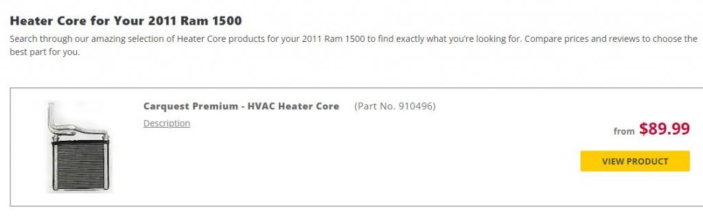

Picture Advance Auto. Core could be leaking from coils, split case, top lines solder loose, could be anywhere. If you have antifreeze in the cab, pretty good chance core has gone bad. Also, before U jump, check the hose connections to the core on the firewall. They could be leaking there at the hose connection in engine bay, but fluid inside cab, usually core. All IMHO.
