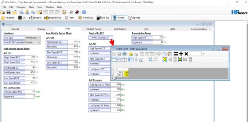

You can put the 180* stat in there, but that still won't solve the AGS and PWM fan settings. I resolved the AGS/PWM by purchasing a new PCM from HPTuners, plus I bought their dongle. Then I went into the tune and adjusted the fan settings lower. I watched the AGS/PWM operation carefully a bunch of times to see the exact temps that everything was activating, and it appears to me that the AGS open/close are dependent on the fan settings. That is, the AGS will open up and then within a short time the PWM fan will start to rotate. This makes sense, as it would be useless to have the fan come on when AGS are closed.
Here's a pic showing the HPTuners page on PWM fan settings: I have mine set at 190*. I've observed it to see the AGS open at ~188*, then the PWM fan comes on within 15 seconds. ECT will briefly reach 197*, then quickly lowers back to ~185*. It all seems to function perfectly, and I think the AGS are actually good to have, especially if you live in a colder climate. I've driven this way for a few months now, with no CEL or any problems at all.
