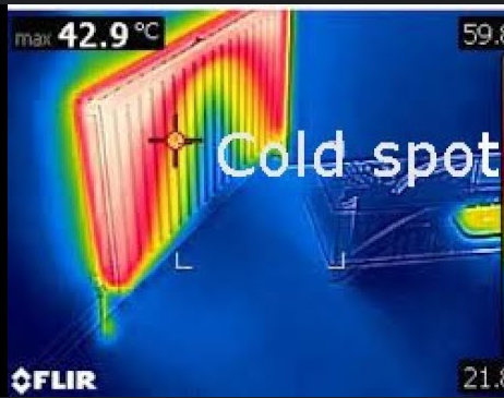

Do you have access to an infrared camera. They are great for finding cold spots in a coolant system. Finding a cold spot can really help find a clog in the system.
If not, maybe it's time to bite the bullet and have a competent shop check over your cooling system before you blow a head gasket or warp a head.
