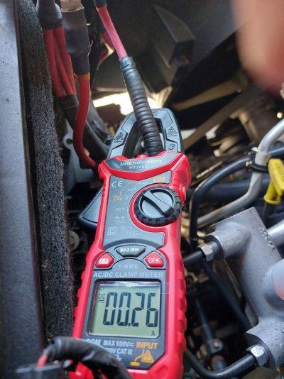

How do I test fan amperage?
Pull the fan relay and make a jumper wire. Put an amp clamp connected to a multimeter on the jumper wire.
Or
Put an amp clamp on the battery cable, the measure the current at idle without the fan running, then with the fan running. Subtract A from B.
Or
Put an ammeter in-line on the aforementioned fan relay jumper wire.

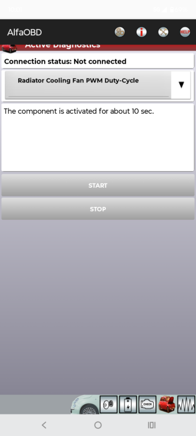

Since it's a 2013+, you have some additional options to help diagnose
With your scan tool or AlfaOBD, some live data pids to watch so you can see what the PCM is trying to do, compared to what is actually happening:
And, see if the PCM is able to turn the fan on/off, indicating that the PCM is keeping it on deliberately (ie, temp too high) vs a stuck switch or relay.
