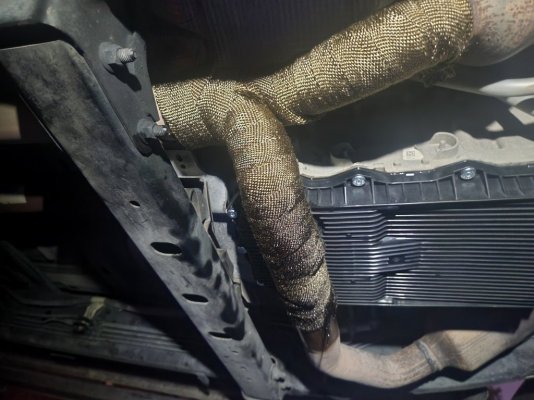

So I finally got to it yesterday, and not a moment too soon. First, here's the header wrap. I know now that I don't have to wrap too far from where they meet at the Y, but even with the wrap and some knit gloves I cold still feel the heat, so I will 100% continue doing it this way. 20221210_175802.jpg

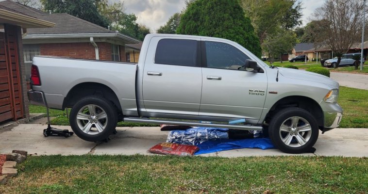

With the slope of my driveway, I still had to get the rear wheel 6" off the ground to level the trans. Those wheel chocks are the real MVPs of this job. I think I want some bigger ones though.20221210_163703.jpg
That tarp was bought specifically to do the transmission and was the smartest decision I made all year. I made a mess all over it.

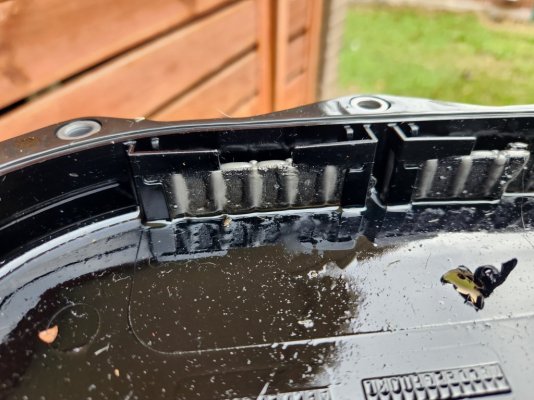

The pan was marked ZF, so I can't say one way or the other if it was ever serviced before. You can see the hole where I drilled it to drain. More about that at the end. All the magnets looked like this. You can just see the one on the right is broken. I don't think I did that. It came out easy enough.

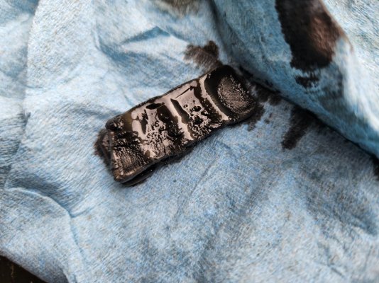

Here's a closeup of the broken magnet.
Assuming the trans has never been serviced, is this to be expected for 151,*** miles? Carfax shows the first couple owners averaged 27k miles a year, which is, in my opinion, a ****load.

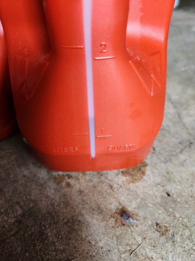

My biggest concern other than all the crap on the magnets, is that I've seen on here that it should take about 5 quarts to fill it back up. This picture shows all that's left of the 2nd gallon!!. Even accounting for the few ounces I spilled on the tarp, this seems excessive. Every drop that came out of it except for the little bit that soaked into the header wrap made it into the catch pan, and every drop of that fit into the other empty gallon bottle. The bottom of the pan and the sides all the way around was dry, so if it's leaking, it's from somewhere else. When I was under the truck last week doing the wrap I took the time to look around at all kinds of stuff and there wasn't any leaking from where the drive shaft comes out of the trans either.
It's been mentioned in this thread and I've seen it mentioned in other related threads that these transmissions are very picky about fluid level. I drilled the hole to drain it before putting the truck on the jack stands, then checked the pan mounting surface with a level before putting the new pan on. I pumped new fluid in until it dribbled out. I don't know how much it took at that point because the hose for the pump curled up in the jug and I had to open the 2nd gallon before the first one was empty. Then I combined those into one bottle before remote starting the truck from underneath, filling it until it dribbled out again, repaced the fill plug, getting in the truck to follow the green sheet procedure, then going back under and removing the fill plug, and then I had to add what felt like a ton more fluid until it started dribbling out again.
After seeing what was left in the bottle I thought I must have spilled a bunch until I looked at the tarp and didn't see too much on it. Certainly not 2 quarts. I guess now I just wait and see what happens.
Now, about drilling the pan to drain. I will absolutely do this again, even though it was almost a catastrophe, as it worked great and didn't start getting all over the exhaust until the wind blew the last dribbles and then that started dripping along the pan and then onto the header wrap. The problem was that when the drill bit broke through the pan, instead of cutting it threaded itself like 2 inches into the pan. AAHHHH!! But I wiggled it a bit and it didn't feel like it was touching anything so I reversed it out and the fluid flowed nicely into the catch pan. I'll use this method again, but in the meantime I'm going to look for or make some type of ring with a locking nut to put on the drill bit to preven it frog going in farther than maybe a half inch. I used a gallon ziploc freezer bag over the drill to prevent it from getting covered in oil. Just poke the bit through one of the bottom corners. In the pic of the pan with the hole, on the underside, there is a flat spot that doesn't have those plastics fins, That's where I drilled, and that's where I'll drill next time, but maybe farther off to the side. On the bottom of the trans, there is some kind of electrical connector that I would hate to mangle, but otherwise there's room, which is why I didn't hit anything with the drill. I didn't know that going in, I just got lucky. The next time I do this at 200k should be a lot easier.
