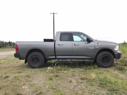

Bils in the rear are not adjustable, just excellent shocks. I have Bils in the front at 2.1 and stock in the back with a 1" TGC spacer.
Agreed with the 1st guy about tires. I have toyo AT2 extremes in 34x11.50 and love them, actually they are my second set! I love the look of my truck but of course I have ZERO bias [emoji12]
I do off-road occasionally but it's my daily driver so I needed a setup that could be comfortable and capable when needed.

Also, I did not adjust my speedometer. Up here I swap my entire wheel+tire setup in the winter. So I would constantly be swapping so I just left it. My speedometer is about 7% off, when I'm going 60 I know I'm roughly around 65
