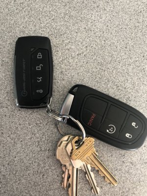

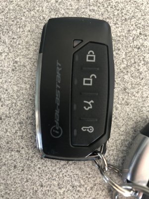

Other mod I did, was one I bought when I ordered the truck but just hadn't a chance to put it in. I've put in quite a few of these over the years for customers. All of my family members have one as well. One downside, is now there are two fobs together in my pocket.
Anyone interested in a remote starter owes it to themselves to research this company's products. On the RAM trucks, install is literally 15 minutes including neatly tidying up the harness. Harness I'm talking about is a "T" harness for various makes and models that are available. No splicing/soldering/hacking up factory wiring harnesses. Definite plus in my books. It does require a local person (or buy yourself) with a programming module to flash the firmware options/model of vehicle from their website.
