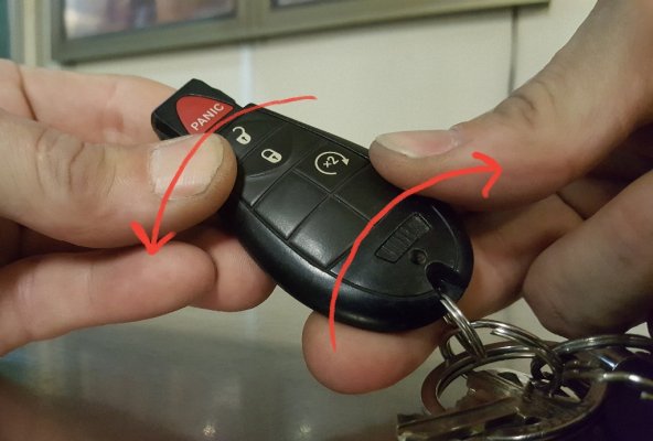

Using the fob like a traditional key, like it was designed and intended, is what may be the root of this problem. The twisting force on the body of the fob over time, might be causing loss of connectivity of the battery to the contacts. Mine has been acting up, working 30% of the time until I tried twisting the fob with both hands and pushing the button twice with a free finger. Everytime I do that, it works.
Yes, however the OP has a 2017 Limited model, which means he has the newer FOB and push button start, so this issue would not apply to his situation. For lower end models and/or older models like my 2012 that have the FOB like yours, what you said may apply. :)
