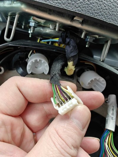

*le sigh* So I pulled the airbag off again, was checking connections, trying the wrecker modules I got and it was hit and miss... till one time it was on bumped a certain part of the harness and boom off. It has a flip down clamp, so everything seemed fine til I unclipped and flipped the clamp thing down and BOOM the issue was kinda staring me in the face.. after seeing if i can unpin the pin the grey wire popped off too.
So the harness I got from the Journey is different in it's orientation... I was originally just going to snip the plug off and splice it on.. but it did work as was just different routing.. So I spliced in the connector for the heated steering wheel and I have to snip off and splice in the horn connector as it was the reverse gender plug. So far so good, but I need to test it for a few days again...

In my last post it says "so far so good", so I guess this would be a 7 month update. Still working perfectly. Kind of annoying, purchased a new brake switch, new clock spring, buttons, probably close to $1000 in parts for what ended up being a $10 junk yard part fix. The proper harness was $200 from dealer. I did end up putting the Journey buttons on as well.
Funny thing is truck when in to the dealer later for AC recharge (I had to swap the evaporator core) and the dealer wanted to do a recall on the steering wheel harness.. basically they put a rubber nub on an airbag bolt and zip tie the harness different in the wheel. I told them not to do it as I didn't even have the proper harness on, which in itself addresses the recall issue.
