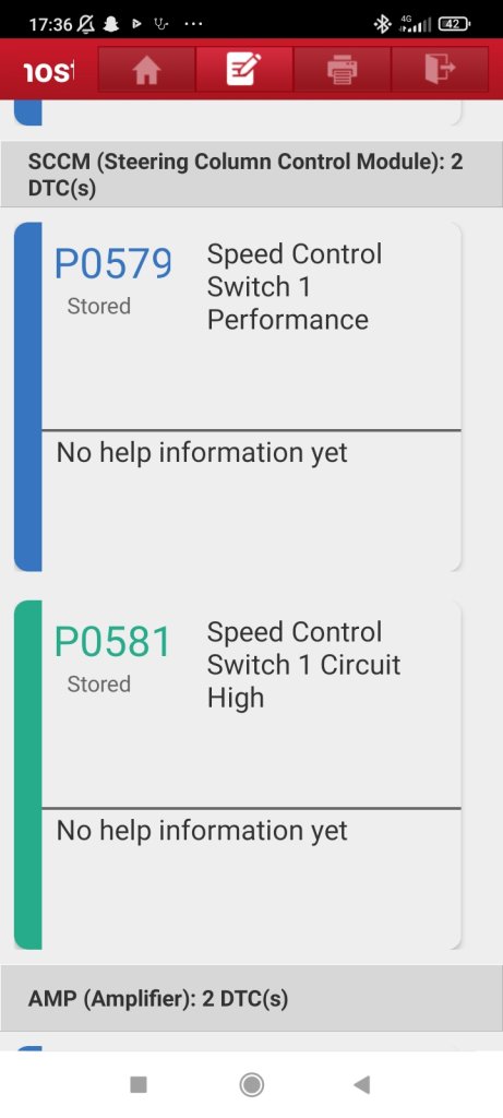

The cruice control is not working, showing code P0579 and P0581
I am not able to reset the fault code. Not sure if it is my software/hardware OBD that is the problem, or if it is the car.

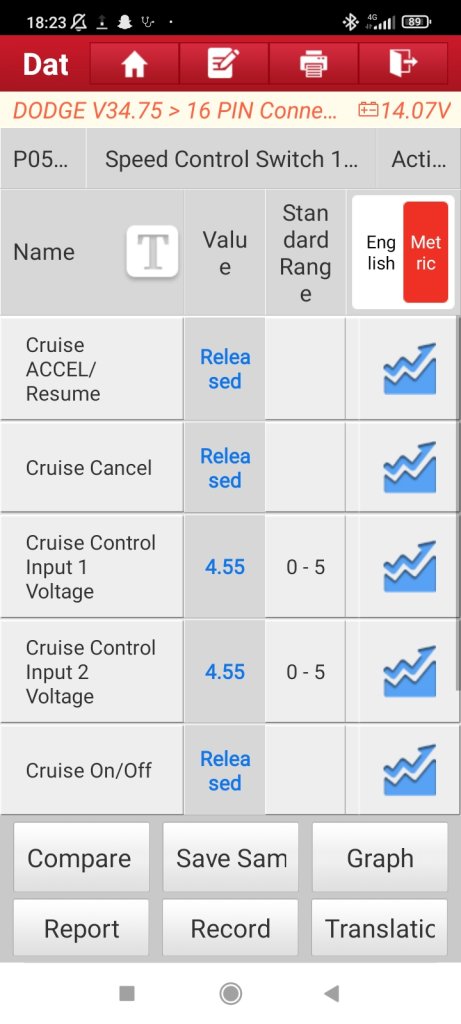

When I test the cruice control buttons on the steering wheel, it says in my OBD program that it is reading different current, when I push different buttons.

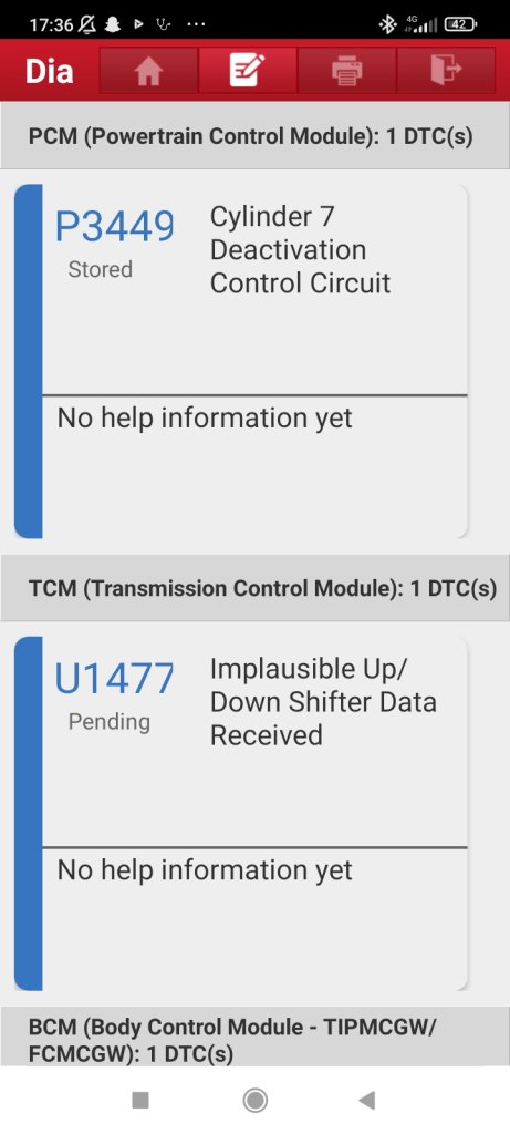

I cannot get the gear +/- to work, and suspect it could be the same issue. U1477

There was a recall a long time ago for steering wheel harness issues. The harness in there is super delicate as well.
There is a reset of sorts that can be done by holding the plus and minus gear buttons for 10-15 seconds. I do it while driving at highway speeds to test if it gets cruise control working again.
Another thing to consider, if you were ever thinking of upgrading your wheel nows a good time to do it instead of throwing individual parts at it to chase the issue.
