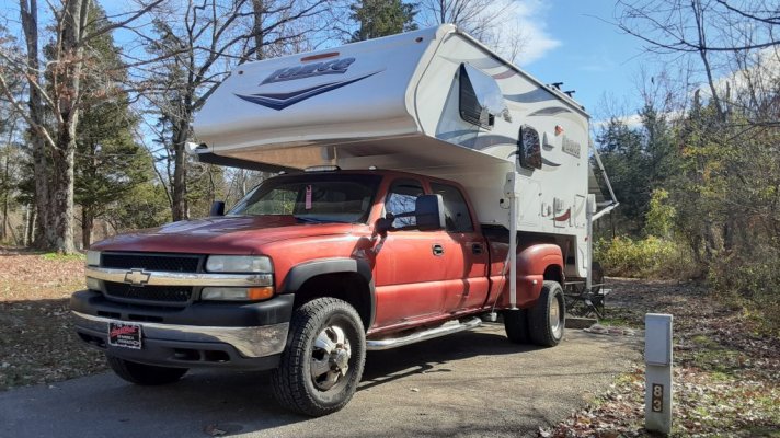

Sorry it's not a Ram, but here's our beast:
I agree that a dually is a pain, but the extra stability is fantastic. This camper wet and loaded is at least 4K (2600 dry) and highest point when loaded is 13 feet, but no rolling or swaying. Granted if you have a pop up or travel really light a SRW would be plenty but I vote for 3500 all the way. This is an old truck 2001 and a bit bouncy unloaded but still pretty nice ride as long as you don't expect caddy comfort lol. I always say you can't have too much truck.
Side note this is a gas truck, CCLB, 21' long and 8' wide, 10mpg empty and 8 loaded!
