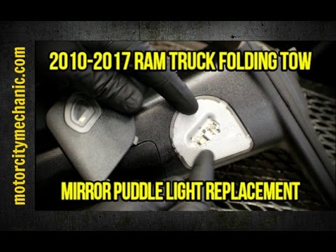

i would not do it this way, but i guess he may it work
this guy did the same thing
this is the way with TOW Mirrors
The way i did it on my 2009 & 2016 mirrors, i simply removed the Mirrors Glass & i was able to do everything easily
one day, someone broke my mirror, so i disassembled it, to see how they were made

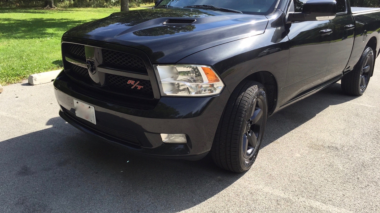

The really fancy trucks have directional headlights. My Laramie has the curb lights. It’s just the fog light lighting up on the side you are turning towards. It’s very nice actually. As others mentioned, you wouldn’t notice that you had that option if your fog lights are already on.
I believe there is a setting to turn this on and off as well in the options on your Nav screen.
