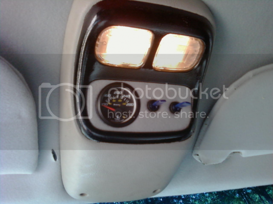

amp and fog lights when thier on they all light up and when you turn key off it shuts em off even while the switch is on lol (battery safty)

things youll need (to do mine)
1) a piece of diamond plate of flat metal
2)temp gauage (electric)
3)2 toggle switches
5 drill bit (same size as switch)
6) jig saw
7) 16 gauage wire
8 spray adhesive
9 gorilla glue
10 headliner materiel
pull out over head console. cut plate to same shape as console hole but leave tabs to glue into place. cover with headliner materiel then glue in place. (i used gorilla glue to hold mine in on tabs). drill holes in patten you disire. run power wire from key on wire on the stereo then mount your switches in the holes you drilled then mount the gauage in hole you cut. run ground wire to any spot of metal and run wires you desire from accesories you have im pretty sure you can wire a switch lol. and gauage pretty simple lol (you saw the out come lol) o and the gauage light i tappe into the cab light (if no cab lights run to parking light or factory gauage lights IF YOU HAVE ANY QUESTIONS MSG ME (JBMOBBS)

i was gonna do 5 toggle switches but i dont have that many mods yet and i needed a temp gauage lol
