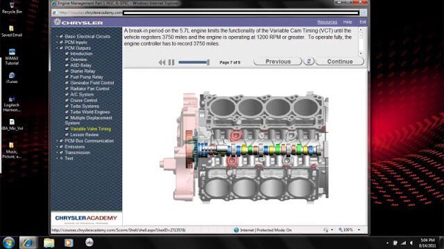

The only confirmed motor to do this is the 5.7 in the cars, but both my 5.7 in my Ram and the 6.4 in my Car "woke up" a bit around the 4k mark. If FCA is confirmed to gimp one motor a bit during the break in it wouldn't surprise me if they do it on all the V8's since they share alot of the VVT/MDS component's.
Easy enough to do with today's ECM software...
