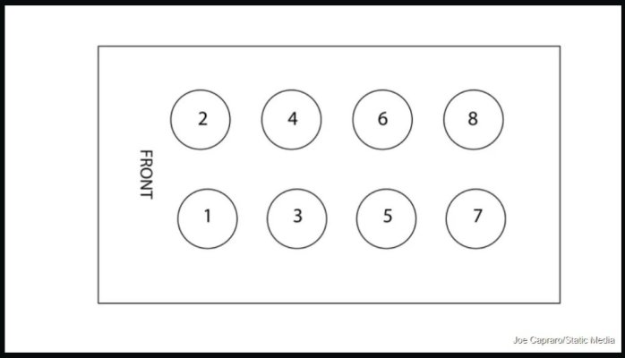

2014 1500 hemi cylinder misfire, in 2019 all cylinders and cams were replaced with aftermarket parts. When I picked up the truck it had the famous hemi tick, never had that before. I told them I didn’t want it, so they replaced the parts 10 months later with OEM parts. I now have a cylinder misfire on 7 the code reads cam issues...sorry I don’t remember the exact code. I bought the lifetime warranty but they say with over 200k miles that’s null and void.....can anyone give me some ideas where to go from here please. The body is in great shape.
Inspect and compare the condition of the plugs in #7 & #5, then swap the plugs between cylinders #7 & #5.
Reset and read the codes again. If the misfire remains on #7, swap coil packs between #7 & #5.
Did the misfire move to cylinder #5 or remain on #7?
If the misfire condition moves to #5, the coil pack needs a rebuild or replacement.
If the misfire remains on #7, further investigation is required.
