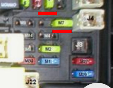

If avail, the slot that the selectable fuse is in will have 3 holes. Moving the fuse from one side to the other (middle common) will change the power source
Non ram for demo
