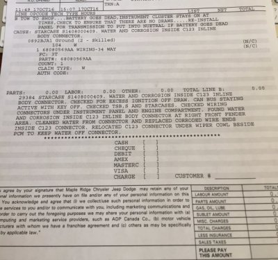

went to the dealer this week with the problem of the dash lights staying on and draining the battery on my 2015 RAM heres what the fix is
this is what the dealer found and did to fix the problem.
That's the same idea the FCA engineer and dealership have and are running checks now on connectors, pins and grounds. Problem is finding which connector, pin or ground (or combination thereof) it is.
Mind if I send this to my SW (your photo?) Thanks for the help!

Last update from the dealership is that the lower switch bank has been replaced and they opened the connector mentioned in AGMRam's RO. They did not find any corrosion inside but did find the pins inside the connector were misaligned and pushed nearly out of the wire end of the connector, so that was fixed. It's now sitting inside and being "watched" for further problems. Tellingly, they've spent far more time with it (8 days now) since they witnessed the problem than when they couldn't reproduce it.
