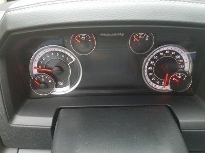

Dash lights won't go off
I have recently purchased a 2012 Dodge Journey and after recharging the battery several times I found the source to be that my dash lights stayed on after parking the unit. I then read numerous complaints about the same problem and determined that the Dealers have no idea what to check. I went to my dealer and they suggested my added accessories were draining the battery which I know was not the issue as I have wired a dash cam and satellite radio to circuits which turns off with the key. Incidentally the radio connection does not go off with the key. They then suggested they could do a full analysis etc and I felt that would just cost me money and still not resolve the issue. So I started testing by trial and error and have now found that if someone opens a door before I shut off the engine the lights stay on. I have to go in and turn the car on (don't have to start it) and wait until the radio comes on, then turn it off and get out and close the door. The lights then go off at whatever time selected on the control switch. The same thing appears to be happening when you leave a door open too long but I'm still working on confirming that.
Hope this may help with other Dodge owners.

I have a 2014 Ram Laramie Longhorn EcoDiesel. My instrument cluster began lighting up intermittently about 2 - 3 weeks ago. A week ago, it stayed parked in the garage for 3 days resulting in the battery being run down completely. My 3 year / 36,000 warranty covered the battery. The service manager stated that the weak battery was causing the instrument cluster to light up at times. I didn't have much faith in that diagnosis but took the truck home. It started doing the same that night. It went back to the dealer and they kept it overnight plugged into their diagnostic computer. It threw a code stating that a service bulletin required a flash on the radio. That didn't work either as it started doing the same thing the same evening. I told them that I felt it was a switch making up intermittently or a sensor. Brought it back and they started looking. After 4 days, it was discovered that the driver's side exterior door handle was the culprit. It has a switch that unlocks the doors when you grab the handle with the key fob close by. It also lights up the cluster when you grab the handle. I would have bet on the brake pedal switch but it is fixed. :happy107:

Just purchased a 2015 1500 Big Horn (first time ram owner!). It's out of factory warranty. First night sitting in the garage noticed this issue. Any suggestions? There doesn't seem to be hardly any consensus of what causes this issue, all sorts of signs pointing to potential electrical shorts, issues with the radio head unit, etc.
So far I've tried all of the "reset" procedures mentioned in this thread. Pulling fuse F49 (ICS/HVAC) turns the lights off when the car is off or in ACC mode. Left that fuse pulled last night but my battery was dead this morning so obviously something is still pulling power. I wonder if it could be as simple as a bad battery???
The dealer I bought from seems to be very reputable so I'm going to see if they'll offer any good faith gestures, but they're not a Dodge dealer so I could be SOL.
UPDATE: Battery checked GOOD at autozone. Dealer offering to take a look on it at Friday as they'll have a FCA certified tech available to look at it.

Hi everyone. I just bought my brand new harvest edition 6 days ago and already I have this problem. In bed I noticed my phone was connected to my Uconnect and I looked outside to find my 8.4 display on and my instrument panel lit. I went outside and found the radio playing also. Truck was locked and keys with me. I already have an appointment with dealer setup for 2 weeks from now (earliest they claim available) to replace the instrument panel lens that was scratched before delivery and to look at my 3.92 rear end that has a significant amount of rust on it. Not very happy already then this happens. I took a couple videos but they are too large to post.

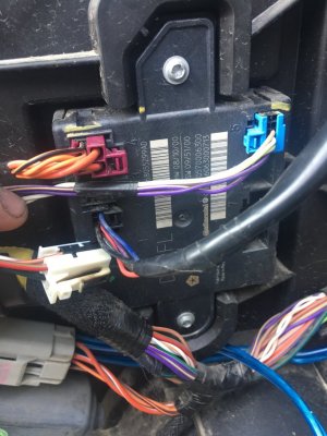

All of my dash lights were on, and none of my gauges worked, windows wouldnt roll down, and wipers stayed on. I thought it was the body control module, but turned out to be a melted/fried door module and plug. Swapped them out, and problems went away. Connection between door module and the plug got corroded, and shorted out. You can see the burnt white plug in my pic.
