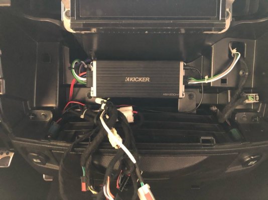

Bi-amp them to me is best, then you have control.
I used our KEY amp, then I can always add a bigger 4 channel amp, keep DSP and time alignment and use KEY as pre-amp.
