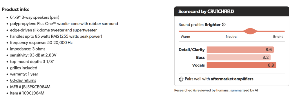

A complely, more awesome sound than the paper stocks
I got the lowest advertised ohm I could find but the sound doesn't make me have to increase the volume at all
Install was pretty easy, shame on Mopar for these pop snap connectors but did even take me an hour to do.
I thought at first I lost some bass... I was wrong, when BASS is called for these babies put out
The sound went from sounding like it was coming from my dash to being surrounded by crystal clear now
I had the non-alpine 6 speaker system with Uconnect5 8.4
I had already replaced my dash ones with some leftovers off my 2017...

Research impedance matching.
The impedance of a speaker is not the same as a DC resistive value, even though it's measured in ohms.
Impedance is a reactive component of a device.
And how it relates to stereos and speakers, the ideal matching is as close as possible.
If your stereo has a 4 ohm output impedance, the closer the speakers are matched to that value, the better the sound reproduction. Mismatching impedance values will likely create losses in sound linearity and potential distortions of the audio content at specific frequencies and amplitudes.
If it sounds great, lucky you. LOL
That's only the tip of the iceberg. :cool:
