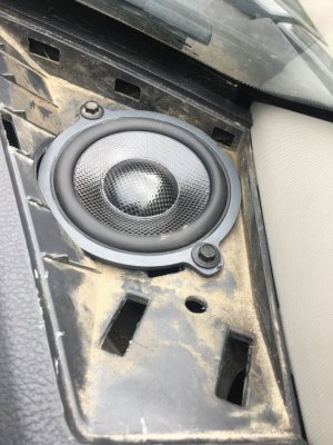

Just replaced the stockers the other day - my oem dash speakers were 8ohm (base 6 speaker setup), replaced with 4ohm Kicker KS and they are certainly brighter. As already mentioned you can adjust fader to the rear to knock off some of it, or stick with the stock dash speakers, or try one of the very few available 8ohm replacements available.
Actually, because I am a bit of a tinker'er - sometimes to my detriment ;), after posting above I decided to swap the oem dash 8ohm speakers back in for a test real quick. To me, even though a lesser quality speaker, the overall balance with the 8 ohm dash stockers is better than with the 4 ohm KS 3.5's.- you can actually hear the front door 6x9's, instead of them being mostly washed out, and you don't have to fade to the rear like you do with 4 ohm dash speakers. I'm going to run it like this for a few days and see how I like it, I don't run a lot of volume but do like it to sound good. Unfortunately, there is not a lot of selection of quality 8 ohm 3.5's that I have found.
As I posted in another thread I replaced both front and rear door speakers with Pioneer A series 6966R's - not the shallow mount G series. Overall it's an upgrade of course, but since keeping the 8.4 HU there's only so much that can be done.

I agree with the above, I did some driving today and the balance with the 8 ohm speakers back in the dash is so much nicer. The sound fills the cab vs having a soundstage up on the dash. Not a fault of the Kicker KS 3.5's, it's just what it is with this RAM OEM setup.
I did run across these 8 ohm 3.5's, decent reviews on Amazon and Youtube, so I might order a pair to try... They seem to be geared more toward building a sound bar than auto application though, not sure if that makes a difference or if mounting holes would line up...

There's just not a lot of 8 ohm 3.5's out there. You can always added in a resistor to a 4 ohm, but then you have to worry about heat.
I'm pretty happy so far with the OEM setup with Pioneer A series 6x9's - the only thing really bugging me at this point is a pretty noticeable panel rattle or similar in the drivers rear door. Oddly, only that door. I have some sound mat so will probably pull the panel and try to deaden it somehow.
