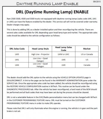

If you're interested in getting them turned on, there are many threads on how to do this if you perform a search. Summary: get the dealer to add sales code LM5 to your VIN. Mine did it for free as it is a quick process.

The dealer I bought the truck from stated couldn’t be done as the option wasn’t available for my vin but he could explore it for $175! I Explained the process and sent him the letter so now he’s looking into it he claims, we’ll see

Thanks to all! I will try that. Razzman, what letter did you get and from where?

Jeff, what does adding that number to the VIN do and is that something the have hook the truck up to do? Can see them charging for that. Really that's all it took to enable yours? That be great.

So I just spoke with my dealer's service rep... What is a sales code she asked (UGH). So not even knowing what I was talking about, even with the threads instruction sheet in hand, she said this cant be done, no bulbs "be careful what you read on forums". After some convincing she said they would try for $121.
I have projectors btw. And so I'm clear, the turn signal bulbs are repurposed as both DRL and blinkers, correct?

I just took the printed page to Keller Bros Ram in Lititz PA (where I just bought my new truck last week) and they were able to turn on the DRL in just a few minutes. They were great about doing it. I gave the page to my salesman Ryan (we were finishing up some paperwork), he gave it to manager Dan who gave it to the service department who said "no problem". Piece of pie. Easy as cake. It was as easy as 3.141592...

With the procedure not having the 1500 listed, are they doing it for them as well?

So on my fourth try I found a dealer 60 miles from me that actually is aware of adding DRLs to a 1500! One hours labor @ $80 and I’ll have them, just gotta make an appointment. The previous three I called all pretty much said “We’re not aware or familiar with that” nor were they willing to try, smh.
