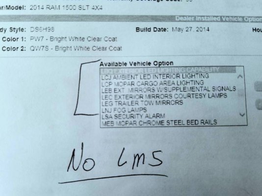

Would anyone know if they have to pick the code from the list? Or does it need to be "added" to the list, then selected? If that makes sense...I only have 2 dealers in town and both gave me the same answer, saying the code isn't available.f043dd3bdba7d97948345a2f5378cdea.jpg

My understanding is that they have to add it to the list first, then they select it
That would make sense to me. I appreciate that. I'll see if can have them look a little harder next time.
