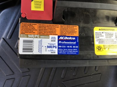

Connections aren't dirty, could have worked themselves loose, but I think that is doubtful
Just went out and tried to start it, not even close to turning over.
This one is going in tonight. My nephew carries AC Delco, I have had good results with them in the past, and he gives me a good price.
Maybe I'll peel the stickers off... :peace:
