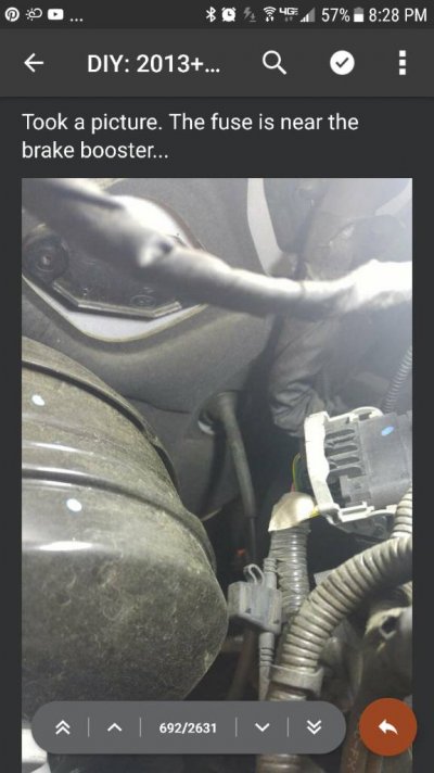

There's an in- line fuse for the radio near the break booster close to the firewall running with other wires . Some are completely wrapped up with the OEM black fabric tape .
This fuse has stumped others in the past ...give it a try [emoji1303][emoji6]
There's pictures of it in the 8.4" Radio Conversion thread somewhere ...I'll look for it and post here if I can find it .
Hope this helps !!
