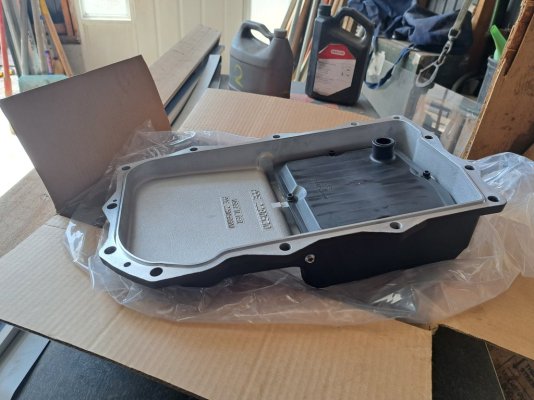

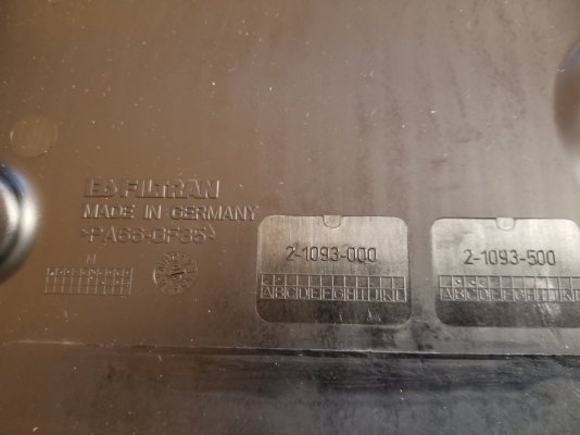

There's alot of opinions on dorman products. Personally i've had good luck with their products. Though IMO the ppe pan pays for itself in the long run. Also those skeptical of the filtran vs oem zf made pans. My 18 ram hemi had the filtran made in usa pan from the factory. So it just depends on budget and preference. I think all the plastic pans are on par.
When I serviced the trans on my '15 at around 100k miles, the original pan was a filtran, made in USA.
The OE replacement 68225344AA
