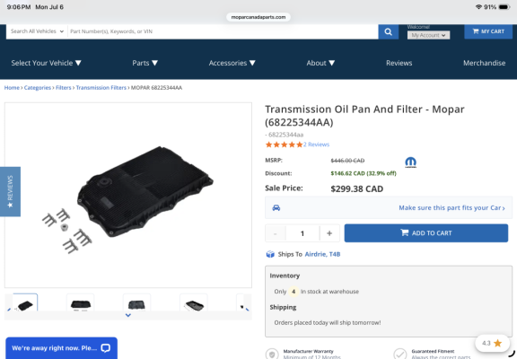

Totally differant transmissions.The 8 speed requires you to buy a brand new transmission pan if you want to change the filter.The filter is part of the pan.

I had a solenoid stick in my 2500 Ram transmission, My local transmission shop charged $380 for the solenoid, filter, and change of fluid. Your $1,000 sounds way out of line.
They’re going to bill you $40/L for 6 litres of fluid. $300 for the pan. $200/hr labour and take 3 hours. And a bunch of shop and hoist fees. You do the math.
I already bought a PPE pan for my 2500. At 24 k I plan on drilling the plastic pan to drain it then changing all my drivetrain fluids with Amsoil. No flush though.
