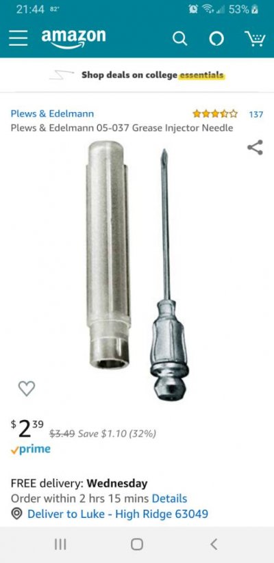

Can someone confirm this will work.
From the picture, the tip almost appears to be like a syringe, like something you would stab into meat to inject marinade? I can’t see that working too well, since the hole needs to be in the end of the needle and the angle of the needle needs to be close to the angle of the divot on the fitting in order to make somewhat of a “seal”.
That doesn't look right - the point should be flat.
Take a look at the where you inject the grease. It does not move into the axle very much at all.
