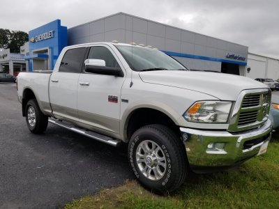

Help! I'm so mad. Just bought a new used truck. Drove great and looked great. Has only 60,000 miles on it. 5.7 hemi 2500. Was gonna use it to haul my horses. Now I'm completely scared of it...
On the drive home on 95 at 70mph it felt like I blew out a tire and ****** me to the right shaking the whole truck. Pulled over, it stopped. Brought up to 70 again and same issue.
I'm freaked out. It's at dealer now and they say it's due to the truck not having original wheels.
Please help advise me. My parents want the truck taken back. I'm in love but now too scared itll kill me or the horses.
Thanks!

I see they said the wheels lol. If those are the wheels in the pic. They’re still factory wheels. Shouldn’t be issues. Unless the factory tires are messed up? Out of round?

It's not the wheels, that's a BS excuse don't fall for that. Those are factory wheels any way. They need to check the front end over. Loose or worn track bar, ball joints, hub bearings, tie rods.

Any idea why the wheels that came with the truck were swapped out with the new 2013+ style? There may be some clues buried there.
