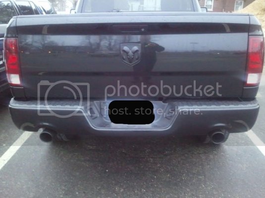

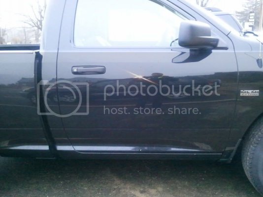

Finally De badged the Express today all you need is the following
1. High Strength fishing line 5$ at Wally World aka Wall-Mart
2. A spray bottle off Goo Gone, * Make sure it is the one for Auto it will say bug and tar removal on it. This will not harm your paint or clear coat on your truck
3. A bucket of warm dish soap to wipe off Goo Gone and 3m tape
4. I highly recommend spraying the Goo-Gone on the emblems and let it set into the 3M tape, so much easier to take off
5. Definitely a car wash after to get a good rinse off for the tail gate and doors
RAM 1500 gone
4x4 on the rear gone
I only left the HEMI badges on and wow does it look amazing.... so clean

I'm not a fan of debadging, but nice work. I also prefer the eraser wheel for removing the adhesive...much easier. I have one because I have removed basdges to paint them black
StLucieHemi
Mar 11, 2012
36
SE Fl
A heat gun works well too. Just warm the offending badges up a bit with the heat gun and "pop" off they come,,, then on to the eraser wheel.
