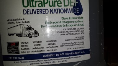

Also guys, look at the UREA%....
UREA is the important part. DEF mostly water. I have seen some DEF from gas stations with under 20% UREA.
I work at a MACK truck dealer. Mack warranty is void if anything under 30% urea is used. This is checked by a refractometer.
Also to save money, Companys will buy 100% urea drum. And dilute themselfs.
The picuture attached shows the UREA % in bottom right.

If not 32.5 it wont work but I dont think you can find any other percentage and if under 32.5 the truck will throw codes. I have looked everywhere and cant find any with out that concentration anywhere
I would be very surprised to see any under 30 or for that matter anything other than 32.5
