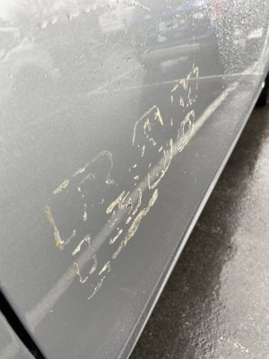

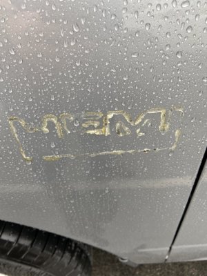

8CF2051B-118D-45E0-8897-DD672C1C719E.jpeg FA951094-09AA-4019-9768-8D98B719BB82.jpeg Yeah, I tried goo gone, goof off, 2 different adhesive removers from Turtle Wax and 3M. None of it worked. Had to go with the eraser wheel. Looks nice and clean now though...
a little advice to anybody considering doing this, more heat and less sawing motion with the fishing line. I messed my clear coat up in a couple soots with the fishing line.

I’m not sure it’s too much extra work, but I couldn’t find anything short of a 3M eraser wheel that would take that stuff off. $50+/-. I still need to polish that area to get the very faint shadow out, but that’s going to be true with any method, and the older the truck is, the worse your shadow will be.

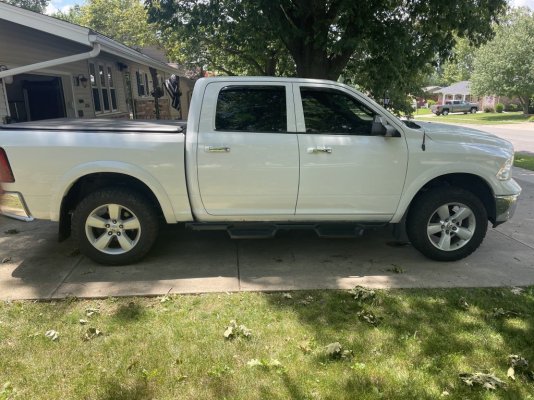

Nice warm day fishing line wrapped around two pointer fingers to cut the adhesive goo gone to clean off the excess IMG_2803.jpeg
