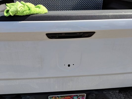

came here to see what people use to get rid of the glue, guess ill share the method i used too
heat gun and a multi-tool knife
the left over dirty adhesive residue and the grooves left behind in the paint by the knife give it character, in my opinion.
looks good from 15 feet away
10/10 would not do again

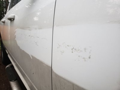

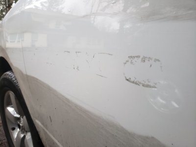

Pretty sure the road debris here in WA state is the main ingredient for Quikcrete. I've tried everything, goo removers, wax and tar remover, solvents, acetone etc
If I leave the truck dirty its hardley noticable.
Think I'll stop by one of the rice car shops and get one of those massive fast n furious graphics they put on the sides lol
Fk it, there are so many rock chips in the paint and sap that dripped all over the hood during the summer that trying to make it aesthetically pleasing would be an uphill battle.

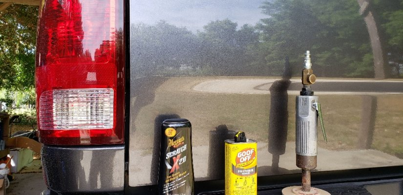

My emblems were on since 2014.
That's where the big horn was. They are all coming off good using this.
