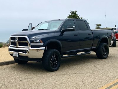

so i have a 2012 Black 2500 Cummins and i would love to take off all of the emblems minus the Cummins C and the ram on the front and back. The only thing keeping me from doing this is 8 years of sun fading. Is there anything out there that would help this out or is it at this point a lost cause and just leave the emblems on?

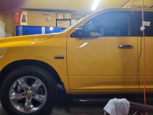

Removed everything off the door and left the "Hemi" emblem on the fender.

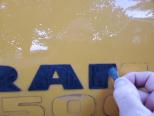

Good god what is that ****? Each of my doors on the B pillar is taking as long as it did to debadge the entire truck! That tape... Wow.

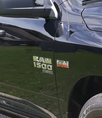

Morning, gentlemen. This photo confirmed my suspicion that the adhesive is different between older trucks and my 2019 classic. I've got a hard glue outline left behind, not the foam double-sided tape stuff shown here. I suspect that's why some folks say "I was done in an hour, start to finish..." while others have no luck with goof off, spray adhesive remover, etc. Wish I had a pic to post of the glue I've got to get rid of. I'm thinking about an eraser wheel, but that's $50...

Mine was taped on. I would say a eraser wheel is going to be your best bet. Thats weird, because my Charger hemi emblems on the side and the dodge in the tail lights were taped. Super easy to remove.
