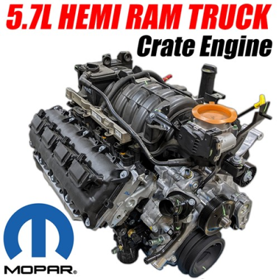

You do not need to remove the intake manifold to make it easier to remove the valve covers. They come off at an angle free and clear (see pic), though you may have a little less clearance on the driver's side. Just remove the valve cover and do what @Wild one suggested above, this way you can just stare at it til you see what you need to see.
Screenshot 2025-06-26 at 09-29-35 1598.jpg (JPEG Image 500 × 500 pixels).png
