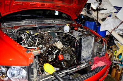

2005 Ram 4.7 160k miles quad cab. All stock.

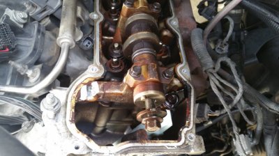

I was changing my timing chains and while changing the guide on the driver's side, I started tightening the guide pivot bolt when it just broke. The top part of the threaded hole just broke off the head in pieces. Can it be repaired? Or is it head replacement time?
I wasnt even to torque specs when it broke :suicide

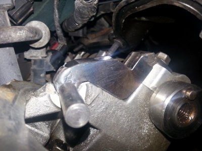

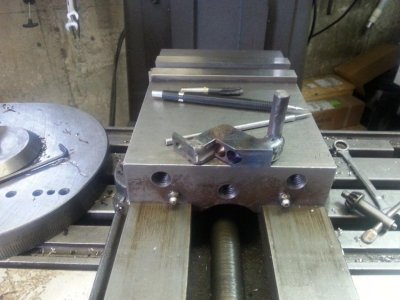

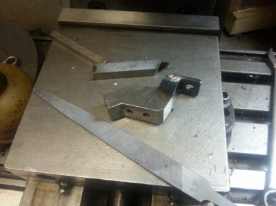

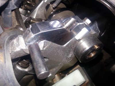

Here are a couple more pics of the part. I don't know if you can tell but there is 2 bolts going down through the part into the head plus the camshaft bolt at the top.
I also did not take the head out. I just put a cloth sheet over the engine to keep the salt and dust out while on the road.
It took the machinist about 4 to 5 hours max to figure out what had to be made and make it. He is an expert at this stuff!!!:roflsquared: Cant help bragging a bit. He is my Uncle:favorites13:
Thanks for the pictures, I am going to print them out and take them to a machine shop and see if they can make one for me. Its going to be tough without them having the head. I guess I can tow it there if I have to since towing is free from my ins. Anything to avoid taking off the head! I also want to get this done before the Texas heat gets here..its MISERABLE.
Your uncle did a great job, you should be bragging. Thanks to both of you guys, Ill keep you posted :)

Glad they help! He did do a bit of filing on the head to make it 90 degrees. Make sure you catch all the filings if they do that. It was quite tight but lots better then taking the head off!!
