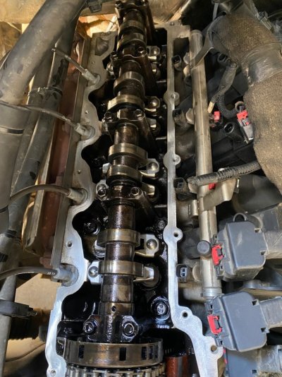

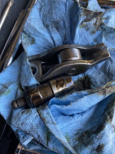

My tick was a couple lifters failing. It seams as a couple oil passages are clogged on mine and starve the lifters. They fail and a rocker arm comes out from under the camshaft. I am about to replace the engine if Jasper will have any available. They are back ordered right now.

I have the hydraulic tappet lifter and find sludge around the diameter of it when I pull a failed one.

It is usually the 6th or 8th cylinder that does this on the exhaust side lifter/ tappet. I have replaced them with Meller but have had them fail again. I think my problem is oil starvation to those tappets because it did it again after 4 weeks of normal driving. I don't think it's the seat as I have to pull them out with pliers to remove the failed tappet. They will also not compress or move once I have removed them to test the insides by compressing (or lack thereof) them.

Its a 4.7 they sludge up you need to run seafoam in the oil I usually let it idle for a hour and change the oil had to do this every single oil change also make sure to do a oil change every 3-4k No longer have worked on tons of 4.7 engines.
