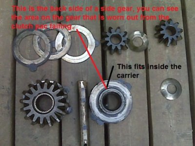

Pull the diff cover and see what's going on inside it. If it has an LSD good chance the retaining clips have broken and the clutch discs are broken letting the side gears clunk.
Next would be the stick tranny, does it have oil in it? Is it the right oil? NV3500 is what you have.
There is also the chance the clutch is going out, but more than likely it the rear diff.
A photo of the LSD in pieces (not all the parts are in this photo).

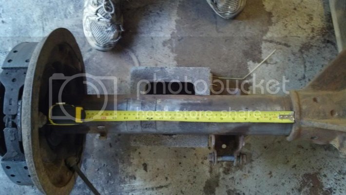

You can rebuild the lsd for about $200 in parts. If there is further damage it can get expensive fast, ring & pinion gear set $150+, new gear carrier $200-$800 depending on what you get, plus bearing's, gear oil $200+ and if you can't do the work yourself $300+ in labour.
Installing just the rear dana 60 (sans the 2500 leaf springs) is almost painless. Two 2.5 wide spring perchs $15, new wheels $$???. There is some welding that needs to be done but no more the 10 min work there, have to remove the old spring perches and move them and weld the new ones on.
If you install just the rear Dana 60 and want to use 4wd it has to have the same gear ratio as the front.

Hmm, seems less expensive, easier yet more effective to do the swap, especially since I have access (albeit 250 miles away) to a pretty well set up shop and welder. When you say new wheels, could I get away with 16s with greater offset or backspacing to clear the bigger drums? Or would I have to go to 17s? What did you pay for your 60s if you dont mind me asking?

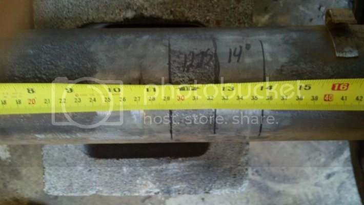

I got my Dana 60's dirt cheap $300 at max for both. I could have just bolted them in and got going shy of needing new rear shoes and cutting the drums. You can use a 16" wheel just fine I do, it's the bolt pattern that causes the needing for different rim's 1500' are 5x5.5 and 2500 8x6.5.

I forgot to mention that yes I did have to shorten the rear DS 58" weld to weld or just find one from the same wheelbase 2500. Forgot about the u-joints as well sorry. There are two opt for u-joints, one is to change the yoke on the 60 so it takes the 7290 joint or change the weld in yoke on the ds to take the 1410 u-joint.
