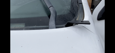

Anyways, trying to improve my offroad lighting situation. The only lights I've had on the truck have been Baja Squadron Pro's in the bumper. Adding a 20inch S8 and already have mounts for ditch lights.

I've got some cheap floods that were freebies in Baja Designs A pillar mounts that do a nice a job. Here's one of my "just detailed" images that just so happens to show them decently well. I was going to put some Baja Wide Cornering pattern cubes up there, but I just can't bring myself to spend the money since the floods have worked surprisingly well for being free.
