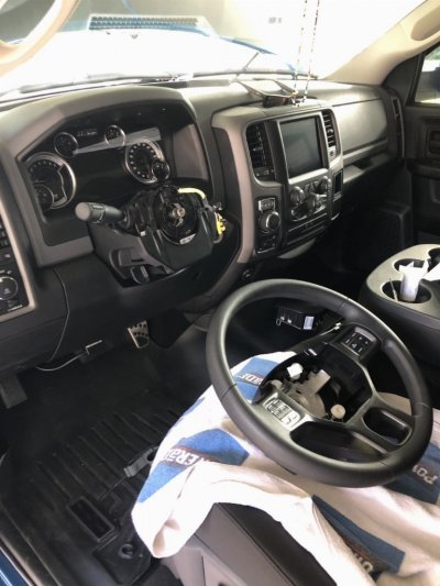

Does anybody have pictures of the switches installed in the back bezel from the front? Also maybe showing the routing of the new harness in the wheel? I received the switches separately from @AllMoparParts.com due to an issue with my order (Benny is a rockstar BTW!) and I want to make sure I get the switches right the first time. I bought the Lisle airbag removal tool (https://www.amazon.com/Lisle-56200-Removal-Tool-Mopar/dp/B073QWMHMP/) to make things as easy as possible (and reduce the risk of screwing something up!).
I'm going to attempt to do this install today.

Hey
Just completed
Have to agree the air bag is a real PITA
Did the silver front Bezel versis the old Black Bezel Looks alot nicer
All PnP made it super easy all buttons working
Almost crapped taking the steering wheel off,using the Puller got distracted an didnt Protect the Shaft
Crushed the starting threads but realized it before too much damage done
Managed to Get the Bolt back in on assembly but took some work to get bolt started
Lesson learned Protect that steering shaft before adding pressure
ended up putting a small nut between puller shaft an steering shaft
Did the tool make it easier? I got all my parts here, but haven't tried it yet. My new 8.4 radio arrives Thursday would like to do the steering wheel controls at same time as radio install
Yes the tool makes the removal a lot easier. Not really needed but definitely easier.
follow the pattern from the old harness
theres a couple wire clips on the lower bezel
