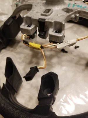

Question I have is this. I bought a harness and buttons on eBay. Pulled the steering wheel off and too it apart. Well the harness that I have had a pair of wires (brow/white) going to the four white round parts. Well this new harness doesn't have that. It has the wiring to both the front controls and the two buttons and the one main white wire at the top....just not the brown and white wire. Can I "splice" or repin the new one for the proper wires?
kegger
Feb 16, 2016
91
27
3.6 pentastar
Two harnesses. My old one on the right.
kegger
Feb 16, 2016
91
27
3.6 pentastar
Ok so I tore the old harness apart and found that the seller must have cut that extra wire off for whatever reason. I've spliced and soldered the old one to that new and hope it works!
kegger
Feb 16, 2016
91
27
3.6 pentastar
Ok new issue. Cruise control stopped working as well as the gear up and down. Can I assume that it's the older harness? It looks like it came from a 2010 and I'm putting it in a 2016.
