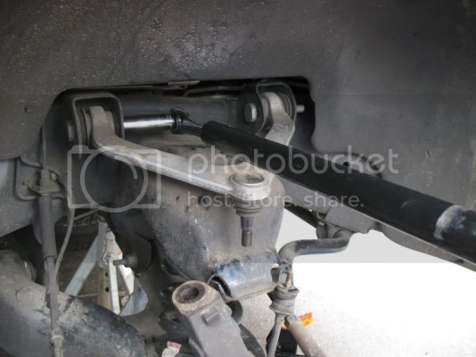

Step #1 - Jack up vehicle, place on stands and remove wheel.
Step #2 - Remove Shock, there are 3 bolts, 1 at the top and 2 at the bottom.
Step #3 - Loosen but do not remove the nut that holds the ball joint in place.

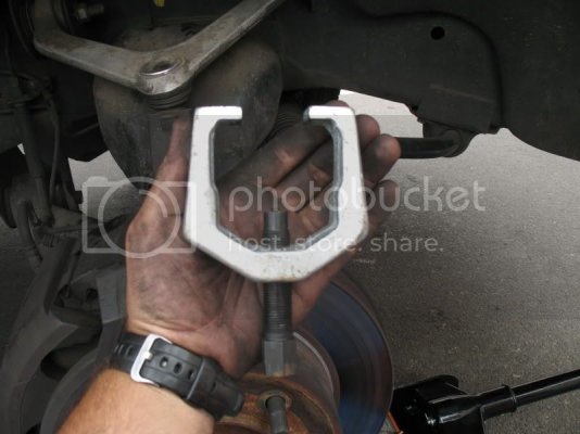

Step #4 - Take the ball joint off the spindle. (This can be done a couple different ways. I prefer to use a Pitman Arm Puller. It can be either purchased or rented from AutoZone for about $14. I never have problems with it even with my 2.5" spacer) To use the Pitman Arm Puller just unscrew the bolt in it most of the way, then place the 2 arms of the tool on top of the spindle, then tighten the bolt until it meets up with the ball joint nut, then just grab a wrench and keep tightening it until the ball joint pops out. trust me, youll know when the ball joint pops out.

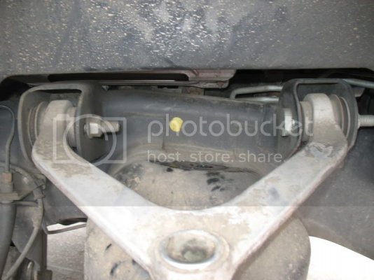

Step #5 - Remove the Control Arm from the vehicle. Keep in mind, the placement of the control arm is one of the things that affects your alignment. It may be wise to mark its location so you can get in the ball park when installing the new one. You may need to get an alignment after the job is done. Its bolted in there pretty tight, I used a cheater bar on the end of my wrench to get the leverage needed to loosen it. And lastly, the bolts are slotted, so dont worry about supporting them while loosening the nuts.
Here is a pic of the old and new arm side by side, and a pic of the new grease point. I got the arm from Rock Auto, it is a MEVOTECH arm with ball joint and grease point already installed. It cost me about $130 an arm, im sure the part is cheaper for those of you with 1500's.
Step #6 - Install the new Upper Control Arm. Its pretty easy, just do the exact opposite of the last step, only with the new arm. Use a grease gun to put some grease in the ball joint, and move it around to spread the grease around inside of it. Be sure to line it up with the marks you made so your alignment doesnt go way out of whack.

You do want to mark where the old one came off, but it was unclear exactly where, until I took it off. Luckily, it had been there so long, I was able to match up from the old indentations. M
y suggestion is, not the ball-joint part but the other two--the wings of the Y, more or less--are in a bracket that slides to adjust. spray around the nut and bolt with spray paint just a little, and let it dry. When you take it off, there'll be a perfect circle to line up the nuts with when you put the new one in.
Even though I didn't have to take the caliper off, I did have to take off the brake line-- maybe caliper would have been easier because I wouldn't have had to bleed the brakes. But you're doing it to get the brake line out of the way because that puller or presser or whatever that ridiculous tool is called is too short to press the ball joint out. A BFH works best, and I removed the brake line and turned the steering wheel so I could get a few good swings at it.
