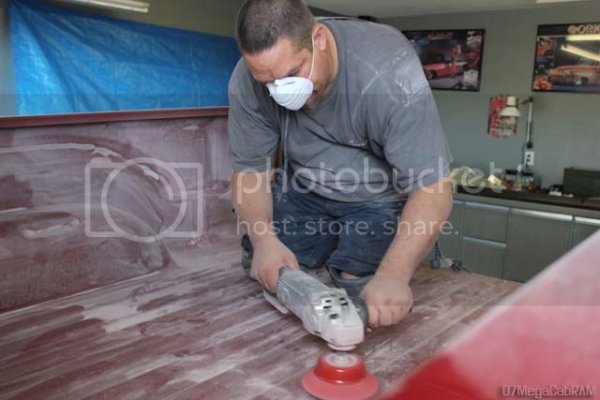

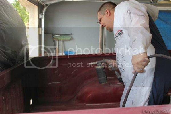

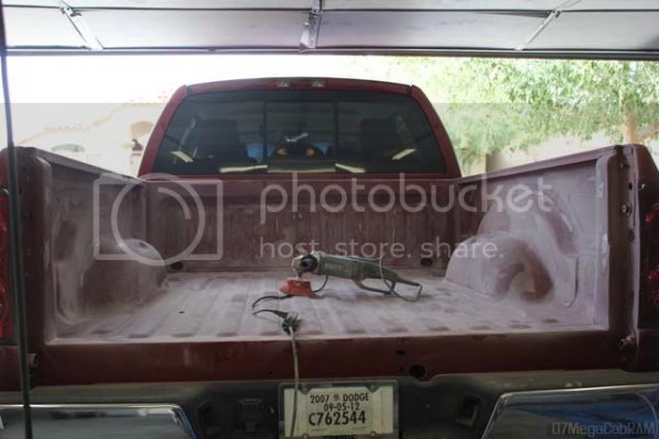

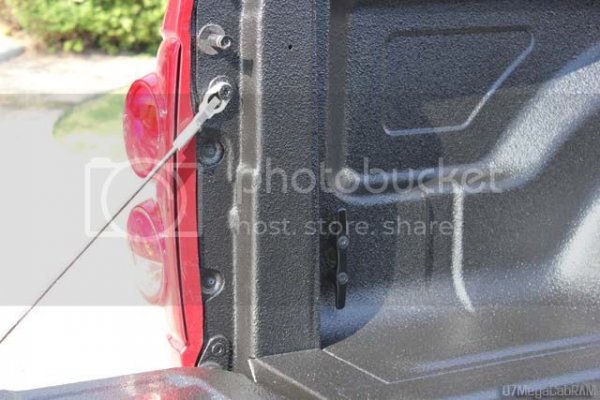

Here is a Defender brand kit I did with my 2007. Loved it, turned out so nice and lasted 3 years and was abused.
But to do it yourself, you have to put some work into it!!
As far as I am concerned, this came out like Line-X and held up like it. Cost me $120 to do my bed. But, now a days, bedliner has come down in price.

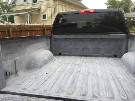

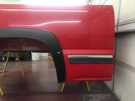

Upol raptorliner. Did mine a year ago. Been great. Done many others also. Done golf cart roofs, rocker panels. Always works great. All in prep work. I took da sander and sanded whole inside of my bed. Then scotchbrite the whole thing. To make sure I didn't miss anything. Used adhesion promoter in hard to reach areas. Was a lot of work. But only ended up spending 250$. The kits come with 4 cans. That's a little thin. I bought 2 kits. Ended up using 6 cans. If you pay someone. LineX is by far the best. But your gonna pay for it.

The top and the panels over the rear tires is raptorliner black kit. The bed and door is tintable kit.

Thanks. Wish I had a before pic of it. It was rough. Used to be cart at chrysler plant.
