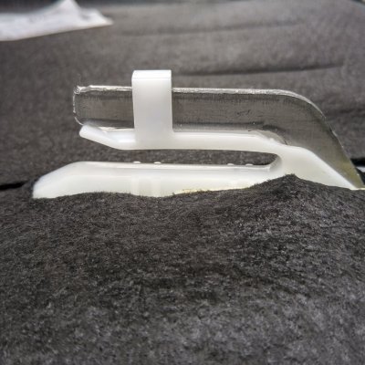

I cut 5/8" off the hooks. Very satisfied. Here's pictures:

Hopefully this works
http://www.ramforumhttp://www.ramforum.com/attachment.php?attachmentid=90205&stc=1&d=1500663315.com/attachment.php?attachmentid=90204http://www.ramforum.com/attachment.php?attachmentid=90206&stc=1&d=1500663315&stc=1&d=1500663315

I cut mine like the pictures John Jensen posted. The only difference is I polished the cut off and tapered the inside cut a little. Works flawlessly without spacers under the seat. I actually did it before ever finding this forum.

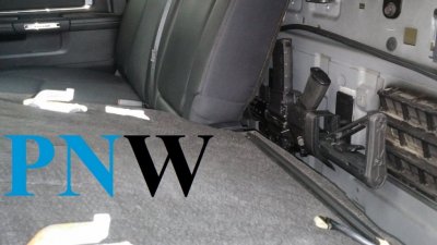

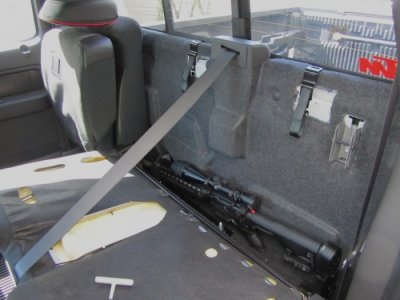

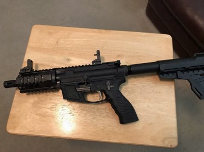

How much space behind the seat does this actually give you access to? Is it really usable for something other than an audio amplifier? I might try this but I don't know if it's worth the effort if it doesn't really gain me much.
Have not done the mod yet but did build a shorty and plan to mount a truck gun in there like these guys did.
