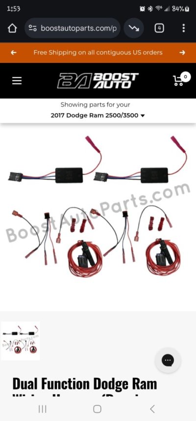

Does anyone know how to make a harness like one from Boost auto to activate the drl in mirrors?
Like this harness that allows the running lights to be on and completely turn off when blinker is activated.
Dual Function Dodge Ram Wiring Harness (Running Light & Signal) 2.0

That's more than just a wiring harness, there is some form of electronics involved that control the mirror light based on the status of the running lights and turn signals.
The modules are about $65, not to bad of a price just to buy them unless your just looking to be able to say you did it yourself.

Here’s a link to how to do this. You’ll need relays, diodes and capacitors. You’ll need pins for the the door modules to insert into connectors. Alphaobd to enable ambient lighting circuit. And you’ll have to run wiring to the bcm.
