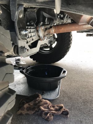

I changed mine a couple weeks ago, it wasn’t difficult however I’m lifted so it’s a little easier to get under. Make sure you have a pan that will hold the 7qts, I think mine holds 15qts. I bought a bigger size because I usually cause a wave when moving it
